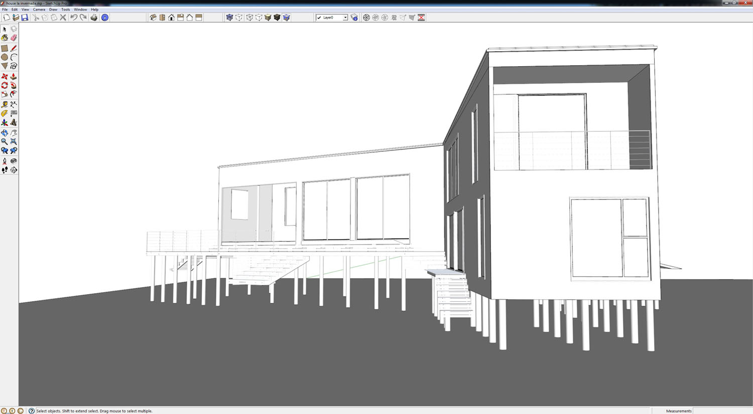

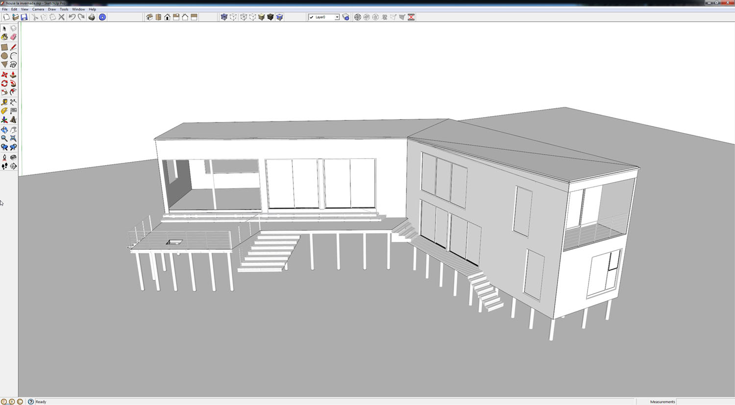

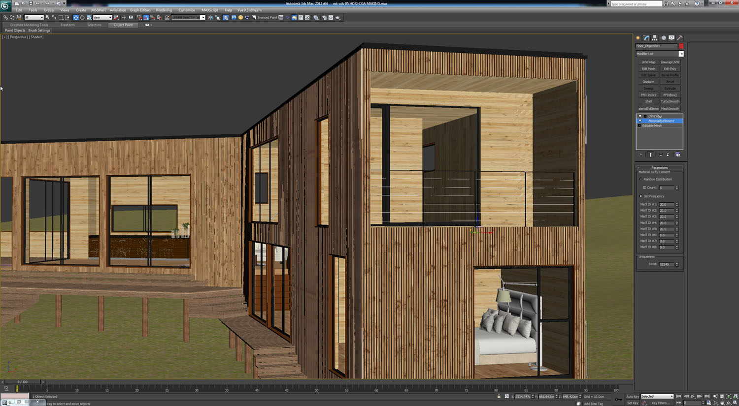

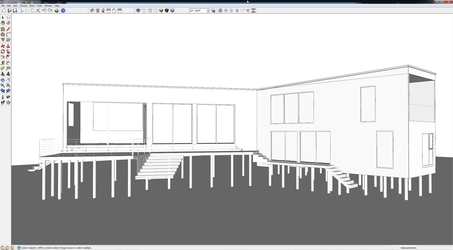

For modeling of the building I used SketchUp and camera match to get the proper size of the building.
Creating the building was not hard, but the most time consuming part was the wooden planking on the walls and the wooden deck. I created the wooden deck from scratch using SketchUp, but for the wooden planks on the wall I use floor generator. All of the plants are 3d models: the trees using archmodels, the grass using i-cube igrass, the dead leaves were created manually. Below you can see the clay render.
Ok, lets talk about the wooden planks on the wall first. The wooden planks were created using floor generator from cg-source.com. This script really helps to save a lot of time. Its free, and very easy to use but can be a bit tricky. Since the name is floor generator, it won't be able to create vertical planks. So what you need to do is to rest the pattern on the ground and generate using the floor generator. Once it generated, select the object, rotate it, and put it on the wall. You can see the process here:

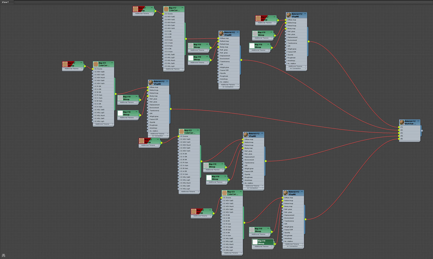

There are two ways to apply the texture for this kind of object. First we can use multitexture from cg-source.com (again, its free) and second we can use multi/sub-object. The weakness of using multitexture is on the thickness part of the planks. As a result I decided to use multi/sub-object for a better result.

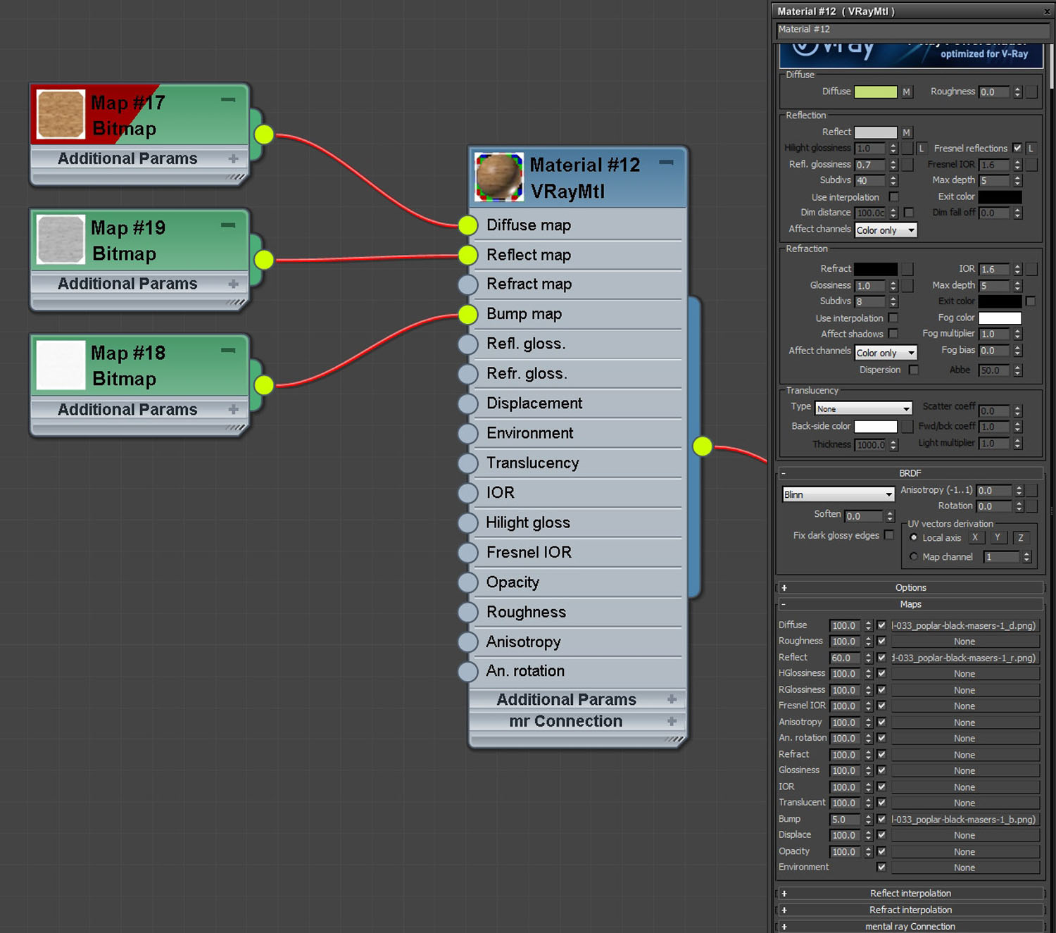

First I create the multi/sub-object in the material editor slot and create one wood texture using arroway wood texture.
I put a reflection map in the reflection slot and used Fresnel. I put a bump bitmap also. For me, Fresnel is the best way to create reflection because Fresnel is physically correct. And the reflection will change based on the angle. After the wooden material is done, I copied it to another slot and make five 5 different materials.
You can see I used color correct to change the color of the diffuse bitmap. I  then assign the material to the planks. Make sure you assign a material by element modifier.
The wooden deck was also created the same way and I also used multi/sub-object material.
The rest of the material is a simple V-Ray material.

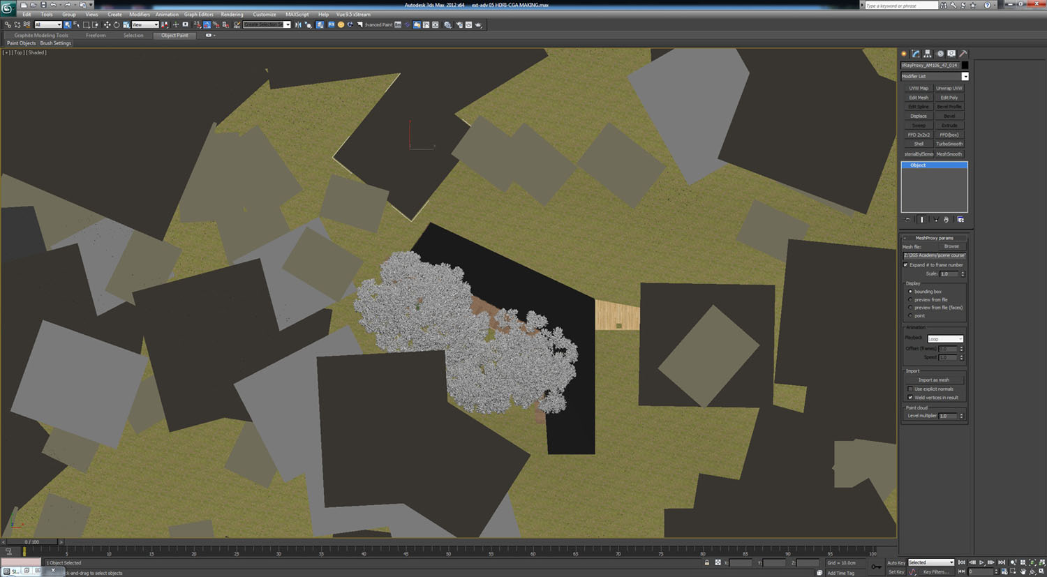

The next step is to distribute the trees. I use Archmodels trees and convert then to Vray proxies. I divided the trees into two categories: background trees and foreground trees. The background trees are all Vray proxies. The foreground trees are 3d models as I wanted to see the displacement of the bark on the foreground trees. Remember, keep everything close to your camera with as much detail as you can.
I then placed some bushes to make sure we do not see the horizon.

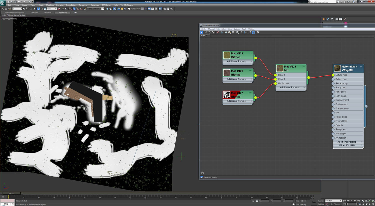

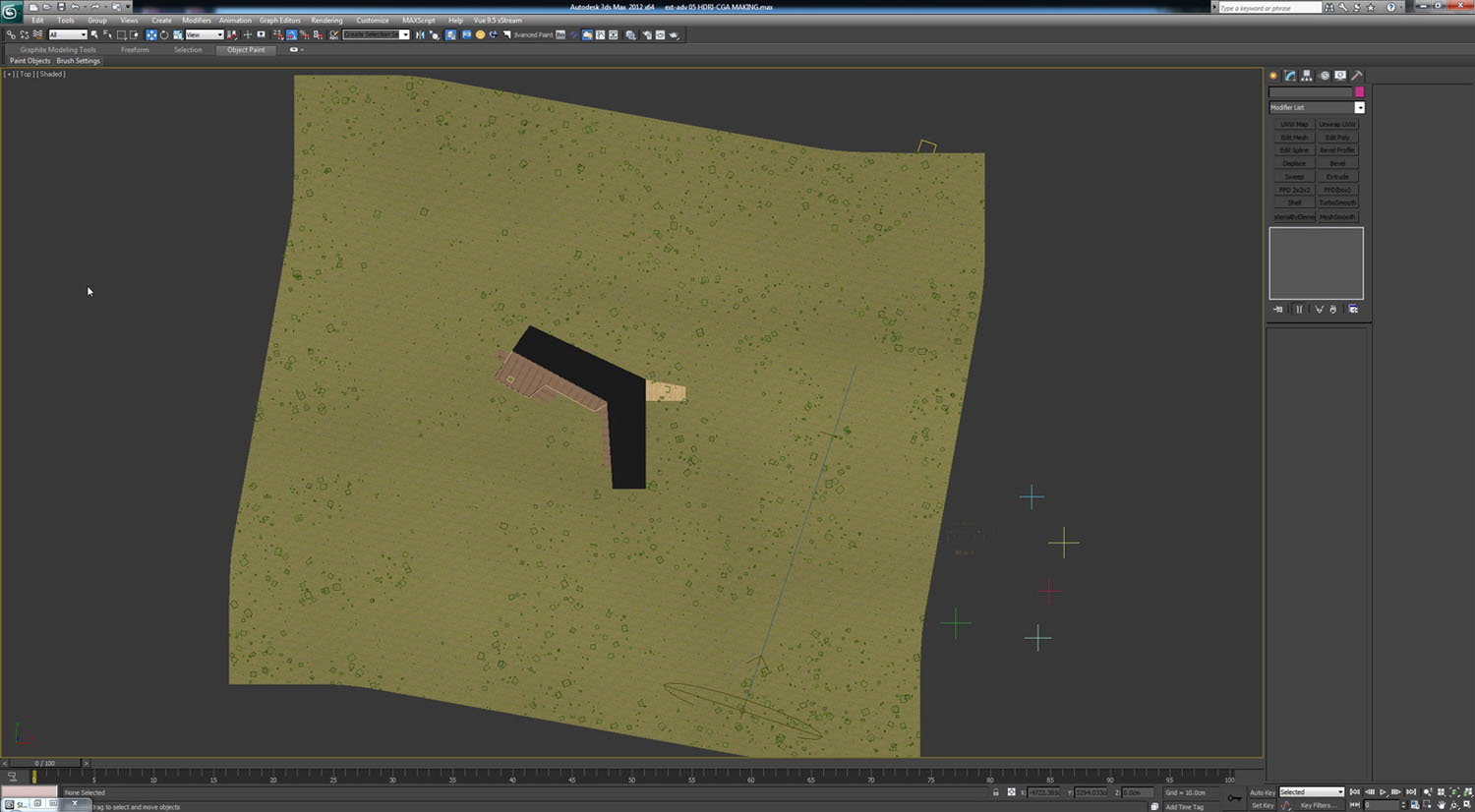

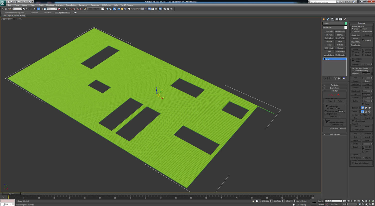

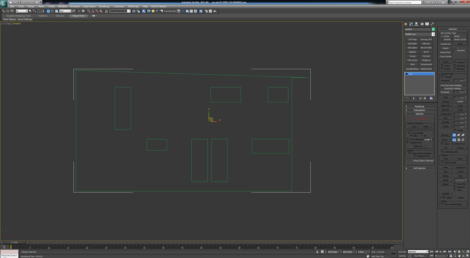

With the trees complete I worked on the grass. I didn't want to only use the grass material for the entire ground surface as I wanted to make it look more detailed. I used a mix material and a black and white bitmap.
I continued to distributed the grass using multiscatter and using the 3d model from i-cube i grass.

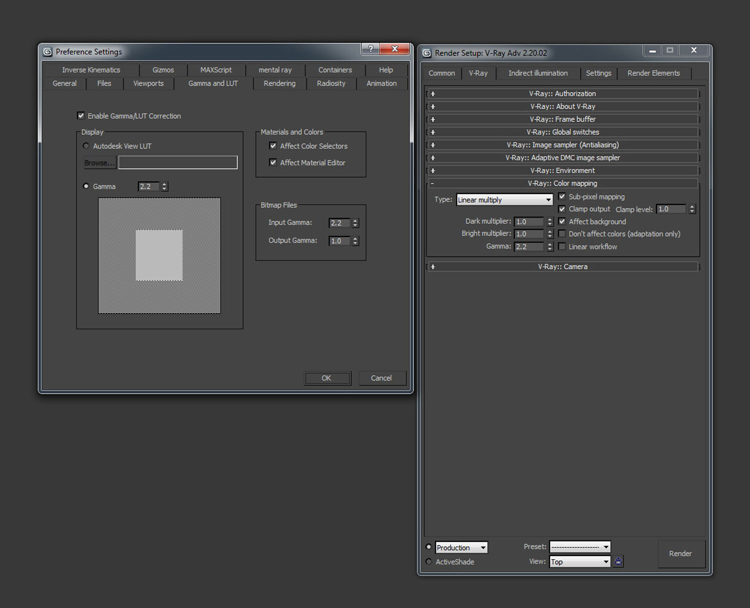

Now lets continue to the rendering part. I used Linear Workflow gamma 2.2 to make sure I get as photorealistic as I can. Here are the settings:
Here are my preset setting, which are nothing special really.

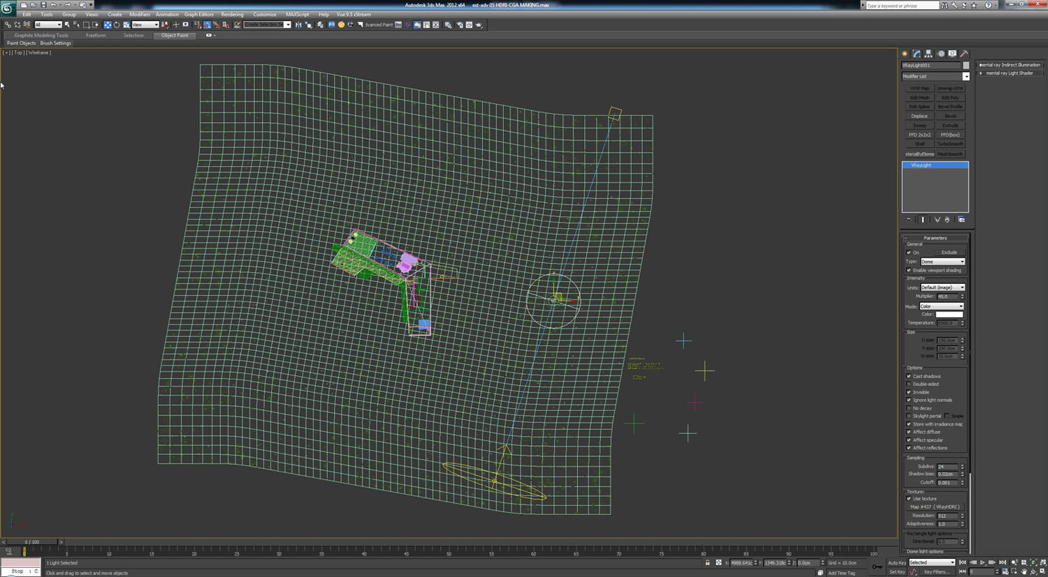

Next I set the Vray physical camera and the lighting. For the camera setting I used an f-number of 8, shutter speed 15, and ISO 100.  For the lighting I used cgskies HDRI. You can download it at www.cgskies.com. You can download the 3000 pixel sample and do some tests before you buy. I choose cgskies because cgskies HDRI is 12000 pixel. We don't need to use any backplates to do the post production since the bitmap is already big enough. Also cgskies hdri have less noise. Less noise means faster render times. I put the HDRI into  vraylight dome and connected the vraylight dome to the vray sun. When I rotate the dome the vray sun also will follow. You can see the settings below:
Below you can see where I put the vray sun.
I wanted the vray sun to hit directly on the building and to go through the tree leaves.

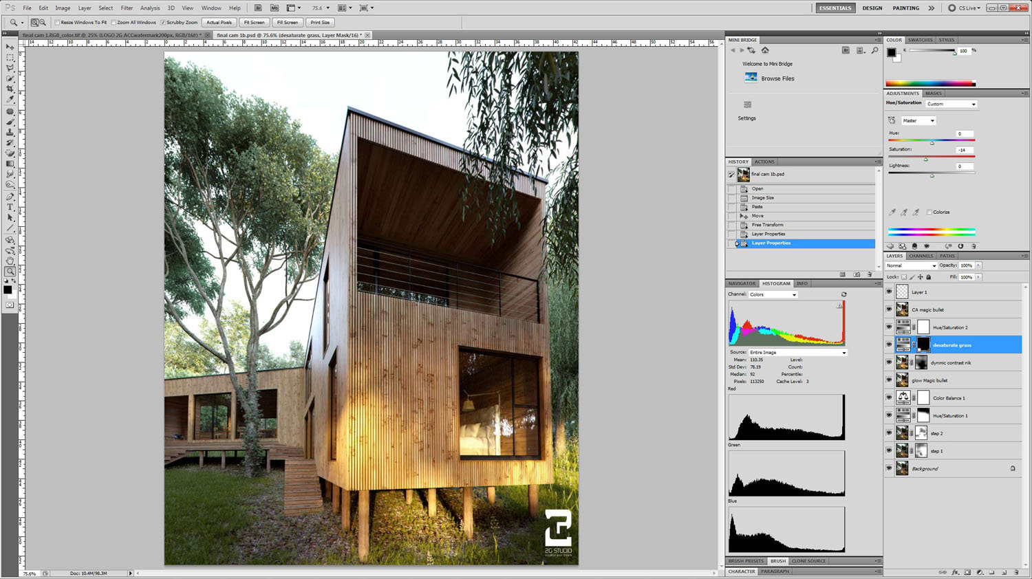

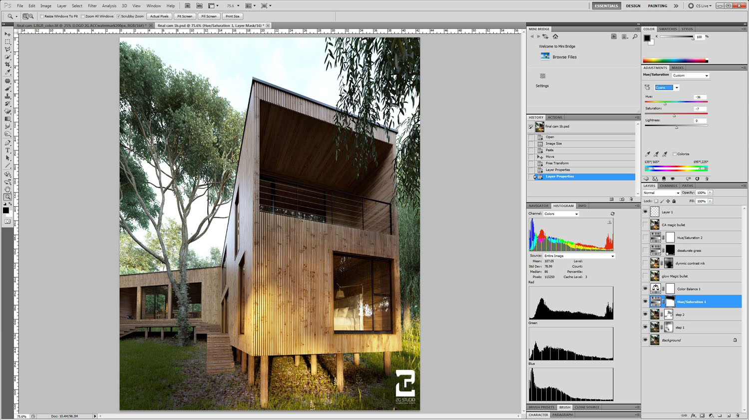

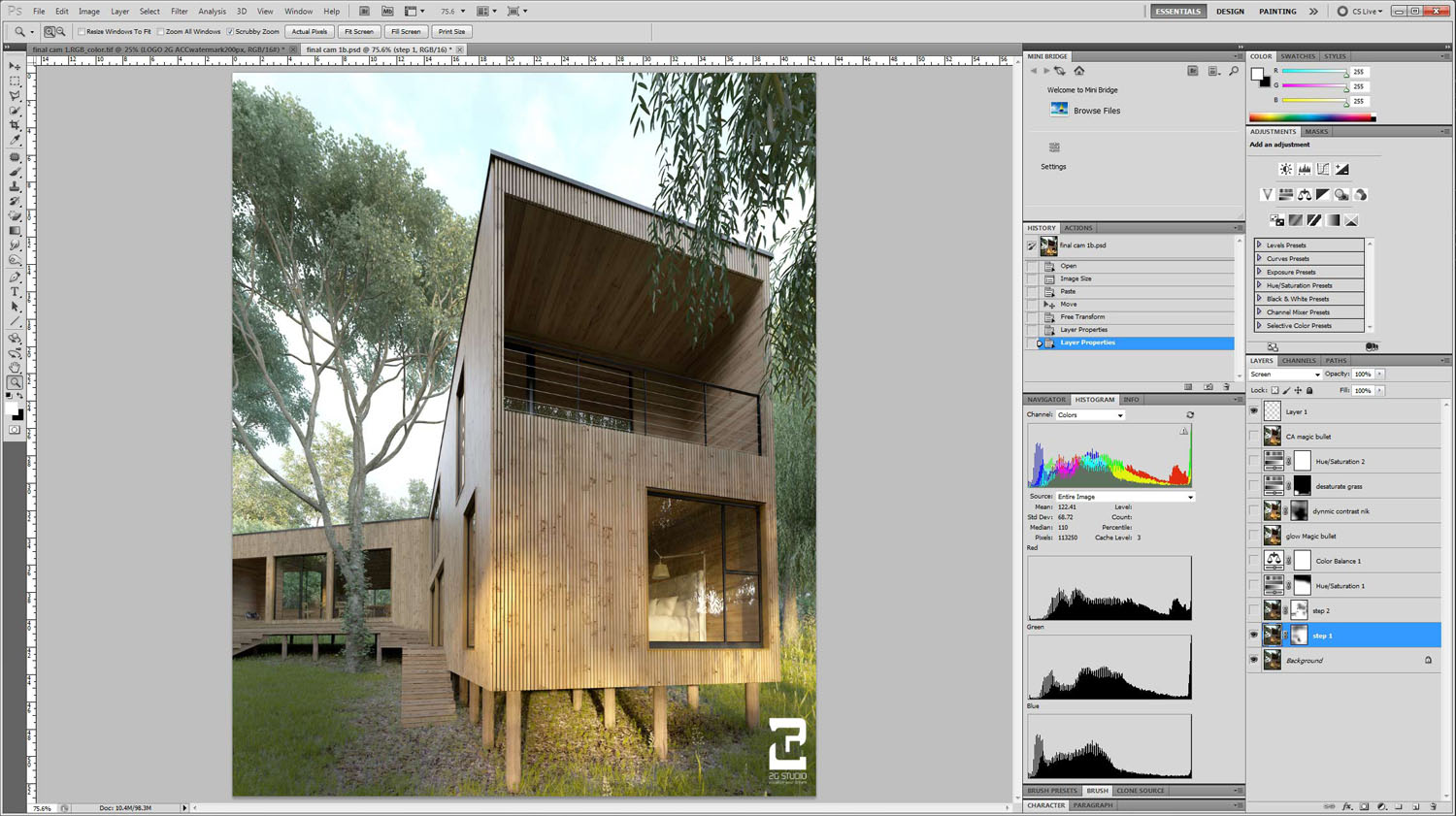

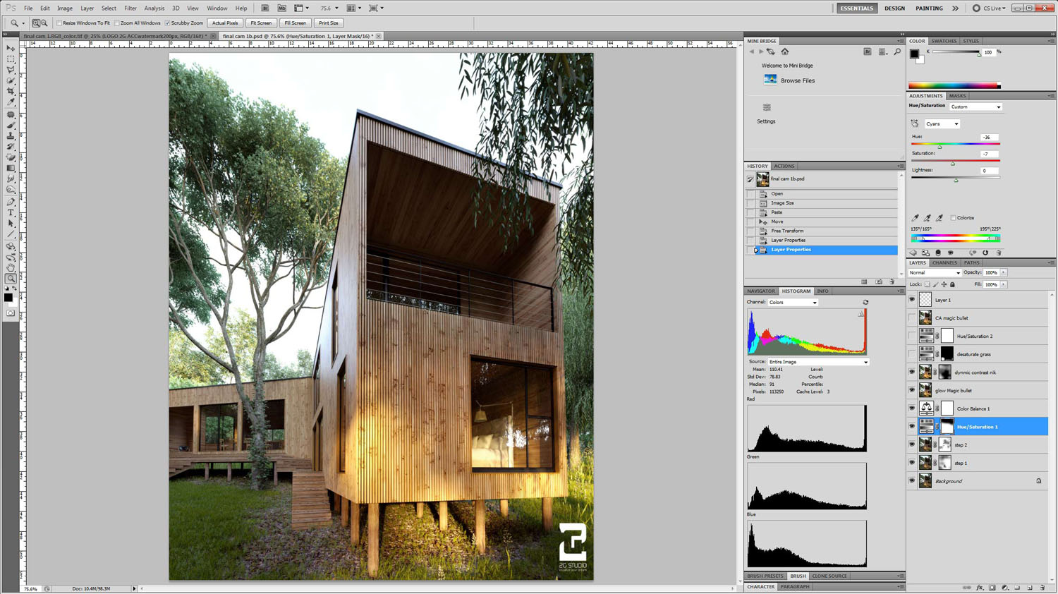

Here is my post production process:
1. I open the EXR and convert it to 16 bit.
2. I duplicate the rendered image using screen mode and delete any overly bright parts using a mask.
3. I duplicated the rendered image again and used softlight mode. I then deleted some parts that were too dark using a mask.
4. I added hue/saturation and color balance to adjust the color
5. I used Magic Bullet to add diffusion
6. I used Nik Color correct to get the dynamic contrast and deleted the parts i didn't like.
7. I didn't like the green color of the grass so I decide to make it less saturated.
8. After that I added a chromatic abbe ration effect using Magic Bullet.
9. The last step is putting the 2G Studio logo on it :p
